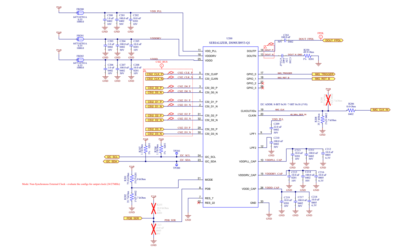

DS90UB953-Q1: Need serializer initialization for image streaming
Part Number: DS90UB953-Q1
I have a camera config that uses the TI954 deserializer and TI953 serializer.  I am using non synchronous external clock mode with 48 MHz CLKIN and need to get the proper register settings for this.  I have attached my current startup script settings and the serializer initialization can be found under the TI953 section.
// default delay 500
retries 5
// logiRECORDER TI954 Deserializer Initialization
slave-id rxPort  // DESER_RX0_IIC_ADDR
	dump 0x00
	delay 500
	{0x20,0x20} //Port 0 forward control
	{0x33,0x03} //CSI control
	{0x1F,0x02} //PLL control
	{0x4C,0x03} //Port 0
	{0x58,0x9E} //Back channel config
	{0x5C,0x30} //Set serializer
	{0x5D,0x20} //Set imager
	{0x65,0x20} //Set imager
// DMS3 TI953 Camera Serializer Initialization
slave-id 0x30
	// Dump serializer I2C address to terminal
	dump 0x00
	{0x03,0x02} //Set mode
	{0x06,0x41} //Configure clock
	read 0x06 size 1 expect 0x41
	{0x07,0x28} //Configure clock
	{0x02,0x73} //Continuous clock mode
	delay 100
	{0x0B,0x05}
	read 0x0B size 1 expect 0x05
	{0x0C,0x0A}
	read 0x0C size 1 expect 0x0A
	{0x0E,0x30} //Configure GPIO
	{0x0D,0x02} //GPIO config
	delay 1000
	read 0x0E size 1 expect 0x30
	read 0x0D size 1 expect 0x02

    Are you able to get LOCK between the 954/953?  What issues are you seeing here?  There are also strap pins that need to be set properly to put these devices in the correct mode?
    Nick
  • How am I able to tell if I got a lock? I am able to read and write registers to both devices over I2C.  I have attached an image of the serializer schematic that shows each pin because I do not think I properly set them up.
    Allow me to review the schematic quickly but you can read back register 0x4D on the deserializer to see if the devices are LOCKED.  Also could you provide a register dump of both the serializer and deserializer?
    Nick
    I have attached a text file for the requested register dump.  This dump occurred after the initialization was finished.  It looks like register 0x4D contained a value of 0x43, indicating a lock since bit 0 is set to 1.

  • I have attached the latest TI953 dump. I also want to note that the CLKOUT to the image sensor should be 24 MHz and I believe that gets set in registers 0x06 and 0x07 which I have set to 0x41 and 0x28, respectively. Can you confirm that this is correct?

  • Hi Taran,
    It doesn't appear that any CSI data is being received by the 953 because none of the word count or data id registers seem to report anything about the CSI data.  First thing is, are you able to test the rest of the system using the pattern generator on the 953 to make sure everything after that is working?  Next can you test the data from the sensor is making it to the serializer?
    Nick
  • Taran,
    Your CLKOUT settings are correct for 48MHz in your configuration. Can you probe the part and see if you are getting the expected frequency?
