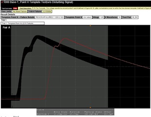

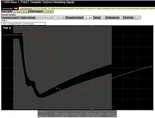

We measure with first board that is failed Pint-F and H. We will second board but other team is suing ociloscope(Agilent). So we will send next week at new board.
Point F:Act 2.212000k Margin -222E+03% No Mask Failure
Point H:Act 2.215000k Margin -222E+03% No Mask Failure
May we have advice for improving?

Hi Kosaka-San,

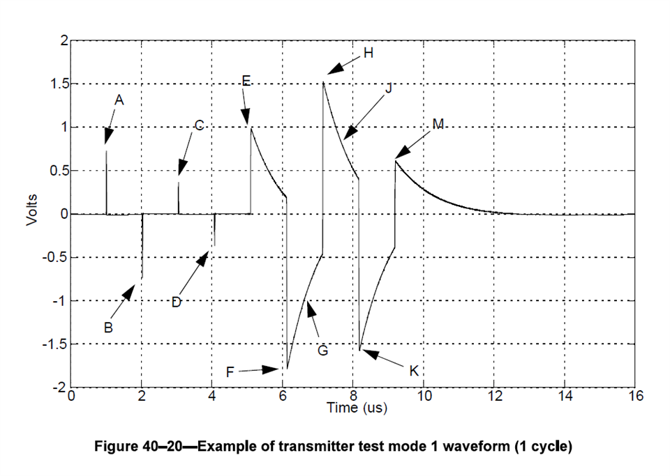

Thank you for sharing the waveforms. Can you please the waveforms in Testmode but without using the compliance software?
It will be easier to understand raw waveforms. The oscilloscope adds a filter to the waveforms.
Can you please measure the peak voltages of points A,B,C,D?
Gokul.

Hi Kosaka-san,
While measuring the envelopes of points F and H, the compliance software applies a filter on the waveform (this filter is specified by IEEE).
Can you please share the direct waveforms from the oscilloscope without using compliance software?
Here is the procedure
These unfiltered waveforms help us analyzing the issue better and to check if we can change settings to make the mask pass.
Here is the reference to points A,B,C,D, F,H

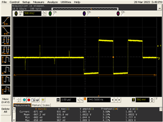

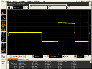

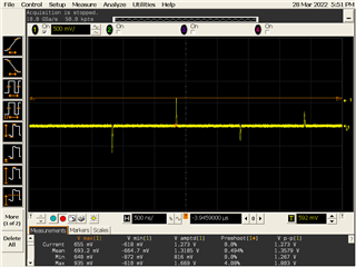

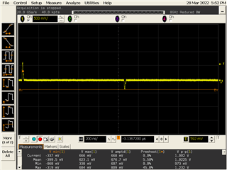

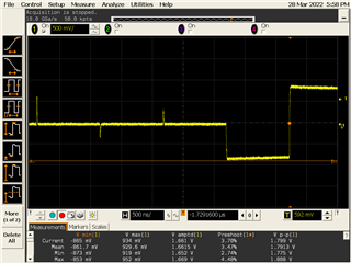

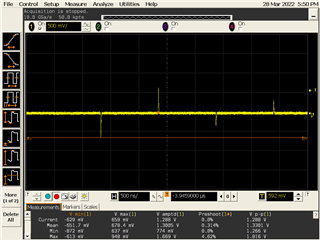

Hi Gokul-san
We measured new board It become worse.
And this signal image is diffrent with example.
Could TI help us for truning?
whole signal image is below.
A
B
C
D
E
F
H
K

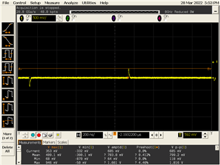

Hi Kosaka-san,
I'm interested to see the rise and fall behavior of these waveforms. The waveforms in the above images don't have a good resolution and we can't get the behavior of the rise and fall.
For this, can you please set your scale of x-axis to 16ns and recapture the waveforms?
Gokul.
Hi Kosaka-san,
Thank you for sharing the waveforms. These waveforms give us the exact details about what rise or fall is causing the template fail.
Usually, the templates should pass with the default settings and the failure can be attributed to MDI side connections and layout.
