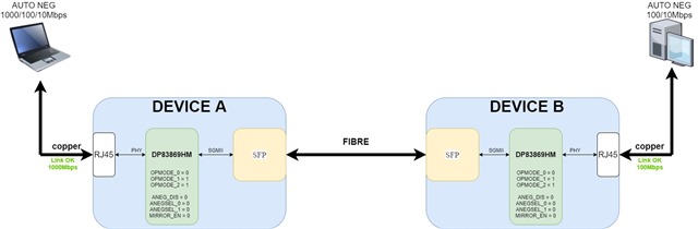

  • Hi Gokul,
    Please, see image below.
    Device A and device B are the same product.
    So Device A is able to read the speed of device B and vice versa, by reading bits 10 and 11 of FX_LPABL register.
    Is there a proper way that Device A or Device B understands that there is speed mismatch?
    Thank you.
    Konstantinos

  • Hi Gokul,
    The block diagram above is representing our application and the configuration. The H/W strap configuration is shown in the block diagram.
    Our mode is copper to SGMII.
    I don't know if the fibre side can work at 10Mbps or not but I can confirm that if Laptop and Desktop PC are connected to copper side at 10Mbps they can communicate. I have tried all the speeds 1000Mbps to 1000Mbps, 100Mbps to 100Mbps and 10Mbps to 10Mbps and it works.
    Yes, I read Register 0xC05. My first post is mentioning bits 9 and 10 by mistake. The correct pins are 10 and 11.
    Please see below examples.
    I remind you that I don't know the fiber link speed. I know the copper side speed. I assume that in order to have communication Fiber speed must be equal to copper side speed otherwise I will not have communication.
    In the examples below I have communication between Laptop and Desktop PC only when Device A and Device B copper side link is 10Mbps. In the other 2 examples I don't have communication because there is speed mismatch.
    Thank you,
    Konstantinos
  • Hi Konstantinos,
    Looks like the mode is not Copper to Fiber, but it is Copper to SGMII.
    In SGMII, auto-negotiation, there is an exchange of the speed and the information is stored in bits 11-10 of the register 0xC05.
    So, you can use these bits to reliably know the SGMII speed of the link partner.
    Gokul.
