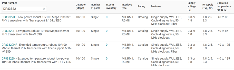

I have designed hardware for DP83822HF interfaced with AM4376BZDND30S . DP83822HF is not available in the market, are there a drop in replacement for the Phy chip. Or can you suggest any other similar Phy chip ?

Hi Siddharth,
DP83822HF is a superior performance device in the the DP83822 series with Fiber support and extended temperature range.
All the DP83822 series PHYs are pin-to-pin compatible. So, there are replacements. However, you might have to compromise on Fiber support or temperature range.
Please refer to the snapshot on the DP83822 series.
