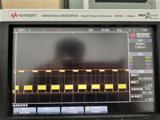

    Also, have you probed the CLK signal on scope to see if CSI CLK is stable?
    Logan
  • Yes, the data of 940 is not transmitted from the 941 terminal. We only set the pattern of 940, we did not set 941.
    And what is the value of the 940 CSI indirect register? the software seems temporarily unable to read the value of the indirect register.
    And the clock on our oscilloscope is really unstable, fluctuating from 80MHz to 160MHz.

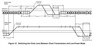

    Does the CSI sink device expect continuous or dis-continuous clock mode? If you see the CLK frequency jump around, you are probably operating in discontinuous mode. Can you provide a waveform of the CLK?
    Logan
  • Csi receiver requires continuous clock input, and we have also set the clock of 940 to continuous clock
    The clock signal connected to the screen is as follows:
    /cfs-file/__key/communityserver-discussions-components-files/138/bbd4d100d418d10a1c294effa406cdca.mp4
    Don't conneted to the screen is as follows:
    The strange thing is that 940's clock is unstable when the screen is connected, and stable when the screen is not connected.

  • Hi,Logan
    The two pictures above are discontinuous clocks without the output clock measured by the screen
    I'm not quite sure why the uploaded video failed, so I'll try again. The general phenomenon is that when the screen is connected, the 940 clock shows a fluctuation of 80~160Mhz

    If you zoom out on the scope when the screen is connected, do you see the CLK switching to the low-power mode / LP11?
    I suspect that this is what is happening, which is causing the Freq measurement to lower on the scope.
    Logan

    After further consideration, if CLK is correctly in continuous mode, it should not leave HS active mode.
    Taking another look at the video, the oscilloscope waveform is correct. So this might just be a weird artifact of the measurement. If not, then try to capture the part of the waveform that is deviating from the sign wave. That CLK signal looks to be correct.

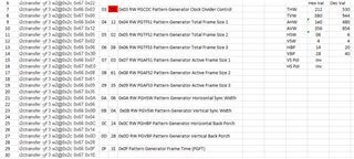

    Based on the 940 PatGen script, I see you are setting the following settings, can you verify this is what the 9211 is expecting:
    • 0x6A
      • Continous CLK mode
      • 2 lanes
    • 0x6B
      • OFMT: YUV422_8
      • IFMT: RGB444
    I double checked the PG script again. I found the following timings were set. Also there is currently an issue with the 0x03 RW PGCDC Pattern Generator Clock Divider Control. Currently 0 is being written to it, which isn't correct. Based on registers, you are using a 480x854 display? Is this correct? The CLK_DIV will be used to set the refresh rate / PCLK based on the display timing. Please refer to the following PG set-up guide: https://www.ti.com/lit/an/snla132g/snla132g.pdf

    We have changed the value of register 03 later, below are our latest configuration and screen timing
    {0x66, 0x00}, //
    {0x67, 0x78},
    {0x66, 0x01}, //
    {0x67, 0x12},
    {0x66, 0x02}, //
    {0x67, 0x22},
    {0x66, 0x03}, // Pattern
    {0x67, 0x04}, // 140*(1/4)
    {0x66, 0x04}, // Total Horizontal Width
    {0x67, 0x12}, // 530
    {0x66, 0x05}, // Total Vertical and Horizontal Widths
    {0x67, 0x02}, // 944 & 530
    {0x66, 0x06}, // Total Vertical Width
    {0x67, 0x3b}, // 944
    {0x66, 0x07}, // Active Horizontal Width
    {0x67, 0xe0}, // 480
    {0x66, 0x08}, // Active Vertical and Horizontal Widths
    {0x67, 0x61}, // 854 & 480
    {0x66, 0x09}, // Active Vertical Width
    {0x67, 0x35}, // 854
    {0x66, 0x0a}, // Horizontal Sync Width
    {0x67, 0x0a}, // 10
    {0x66, 0x0b}, // Vertical Sync Width
    {0x67, 0x0a}, // 10
    {0x66, 0x0c}, // Horizontal Back Porch Width
    {0x67, 0x14}, // 20
    {0x66, 0x0d}, // Vertical Back Porch Width
    {0x67, 0x28},
    {0x66, 0x0e}, // Set Sync Polarities
    {0x67, 0x00},
    {0x6a, 0x22},
    {0x6b, 0x50},
    {0x65, 0x04},
    {0x64, 0xe5},
    Please help verify it again. Thank you
    regards
    jie
  • Hi Jie,
    Yes, this looks correct now.
    With a CLK div of 4, you can expect a PCLK of 140MHz/4=35MHz (+/-30%). So the refresh rate will be 35MHz/944/530=~70Hz.
    I'm not sure what else we can recommend here other than analyzing the CSI output of the 940 with a CSI analyzer. PG script looks okay, and clocks/data you attached look okay.
    Is it possible the input of the 9211 is not configured correctly?
    Logan
