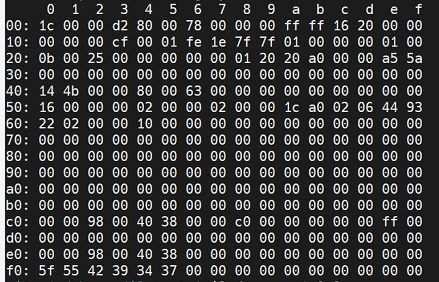

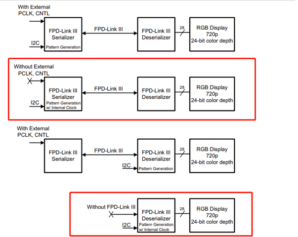

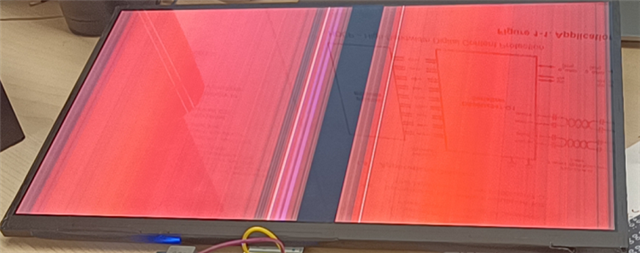

Our customer used DS90UB947+DS90UB948 for Pattern test,and he tried the below two mode, unfortunately, there is no display and the Pass&lock are both low level.
 Could you please help to analyze?
Best regards
Kailyn
This is the register configuration of DS90UB947:
and the register configuration of DS90UB948:
