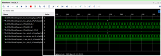

  • I did not get a chance to check the voltage of TX_EN (the card is slotted in and I didn't have time to find a way to tack a wire to that signal.  However, I did hook the DP83867 to another DP83867.  I was not transmitting from either board.  But on the board set up on the receive side I was seeing an RxDV transition for every RxCLK!  I don't get it.
    I do not see the rx data changing, it stays the same throughout.
