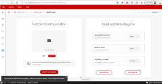

  • thanks Eric . I emailed you from my mail id for C drivers. Meanwhile , I am also checking GUI only to evaluate modes. But I am getting below error when I connect EVM board with Mini USB. Whatlese I am missing here.
  • Hi Yogini,
    Thanks for sending that over. I have responded to your email with the demo drivers. Let me know if you have any issue opening the attachment.
    It appears that the MCU on the EVM is not getting a response from the transceiver. Is the TCAN1145 properly powered? Vsup and Vio will need to be present for SPI to be active. Also make sure that the switches on the back of the EVM (S7) are switched on to enable the connection of the MCU and transceiver.

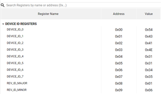

  • As per GUI,  below are the expected values for registers;
     I want to read the the register 0x10, whose value should be 0x01, or 0x04 or 0x07; in sleep or standby or normal mode. But I am only getting value = 0x54 , which is the value of register 0x00.
    I don't know what am I missing in the code.
  • Hi Yogini,
    I agree, it sounds like the transceiver is only seeing 0x00 as the address, and is therefore returning the DEVICE_ID value. Apologies, but I'm not familiar with the SPI driver so I don't think I'll be much help in debugging the code here apart from at a high level. My recommendation would be to connect an oscilloscope or logic analyser to the SCLK, SDO, and SDA lines and monitor the SPI frames. This will let you correlate which function calls correspond with what physical SPI actions. This would also help you check and see if the format of the frame is matching the requirements shown on the TCAN1145 datasheet.
