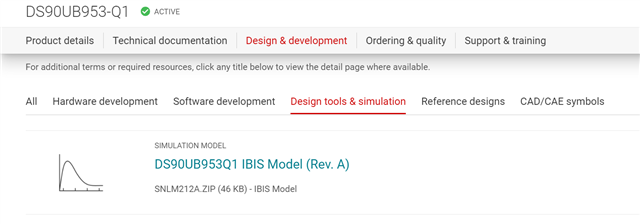

  • Hi Frank,
    On the 953/954 product pages, there is an IBIS model available for download:
    If your customer would like the IBIS-AMI models, then they need to have an active NDA with TI that covers FPD-Link parts. Please send me an email with information on the NDA agreement if you would like to share the IBIS-AMI models.
