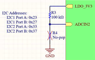

I have three prototype custom PCBs which each have a TPS65988DHRSHR chip.  On each board, I have the ADCIN2 voltage divider setup like so:
On two of my three boards, the chip correctly responds to an I2C scan on I2C1 for the addresses 0x23 and 0x27.  However, on the third board, it answers to 0x20 and 0x24.
I probed the ADCIN2 pin on each board, and they all show a voltage around 3.2 V.  What else could cause this one chip to respond to the wrong address?
