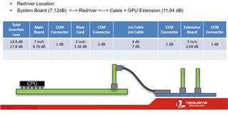

could you please suggest PCIe Gen3, or Gen4 Re-driver solution,
The Insertion Loss part has about three parts
1) Main board will have about 9 dB insertion loss
2) Cable has not been finalized yet, about 7dB
3) Device will be 4dB

Hi Gareth,
DS160PR410 is the correct device. This part can compensate for close to 42dB total channel loss. It seems here you have about 20dB total channel loss. Please consider running signal integrity analyses using DS160PR410 and s-parameter model of the transmission media.
