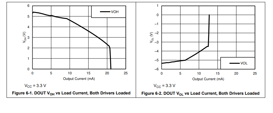

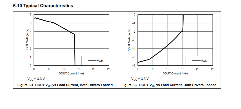

Hi Ishiwata,
You should be okay to switch out the devices - they are rated to the same standards (TIA/ EIA-232-F and ITU V.28), have the same pinout, and can transmit up to the same max data rate (250kbit/s).
The one difference that I did notice, shouldn't be that much of an issue but it seems the "E" version you would switch to, has a lower max current drive on the driver pin (shown below):
"E" Device:
Non-E:
But if operating in the lower output current range - there isn't much difference between the parts as the rest of the parameters seem to be spec'd the same.
