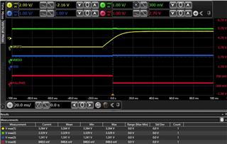

We have external 4.7kOhm pull down on pin 36 (FULLPWRMGMTzSMBA1/SS_UP). Below is what measured on board.
- Pin36 is measured to be 0.85V before reset released. Is this expected?
- Based on the datasheet at 7.6 Power-Up Timing Requirements, the Tsu_io and Thd_io are measured with respect to GRSTz's VIH or VIL?
- Based on the scope capture below do you see any issue? The pin36 goes low while reset is released.
Green=VDD3v3, Blue=VDD1V2, yellow=GRSTZ, RED=FULLPWR
Thanks.
  • Hi Yen Nee Lee,
    Yes, this is expected behavior since the FULLPWRMGMTz pin has an internal pullup that is +/-225 uA (max).  850 mV seems a little high, I would expect the real value at the pin to be closer to 800 mV.  The TUSB8020B should be able to sample the input low properly.  I don't see any issue here.
    Tsu_io and Thd_io are mesaured with respect to GRSTZ Vih.
    Pin36 will go low after it has been sampled and it becomes a status output (SS_UP).
