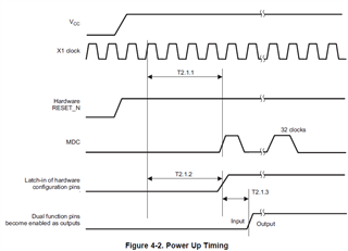

The datasheet for the DP83848-EP has Figure 4-2 which depicts the Power Up Timing,
From this timing diagram, there doesn't seem to be any device terminal that can be directly probed to determine if the device is up. My aim is to be able to probe the device in-circuit, to determine its power up timing performance once the power rail and clock have stabilized.
