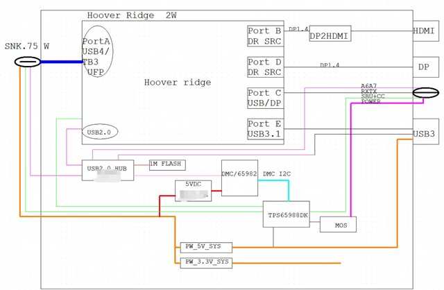

Hi Taylor Vogt
Intel only has U4 block diagram. It is Hoover radge+cypress(CYPD5225+CYPD3177)
Colin,
If you want bus powered, you would need to follow our datasheet guidelines for dead battery mode, but please understand this is not in a reference design so you would be taking a risk not following the reference designs referenced above so it would not be the preferred method. It sounds like you already have access to the intel designs above so that is the extent of the references we have available to you.
Taylor
Hi Taylor
I will send the schematic diagram to your email, do you help me review it? I also sent it to Intel to help me review this BUSPOWER mode
