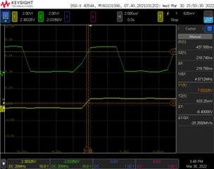

Dear Team,
We have measured Tpv which follow datasheet figure7-2/7-3 and note B(0.7 × VCC on SCL to 50% I/O (Pn) output).
But the result is out of datasheet spec, could you share your comments with us?

  • Hi Ben,
    Something about the yellow waveform looks a bit strange to me. It seems like prior to the measurement the signal is transitioning from HIGH to LOW, then only 3 clocks it transitions from low to high. For our device, we require atleast 9 clock cycles to transition from low to high or high to low. I'm a bit skeptical this is the Pn pin.
    From my testing/validation of this parameter, I recall the output actually changes at around 30% of the of the SCL ACK pulse. So usually the tpv time is actually negative.
    Can you redo your measurement with the SDA/SCL pins and double check CH1 is indeed connected to the p-port.
    -Bobby
  • Hi Bobby,
    We have remove C_load and measure Tpv timing again as attached picture.
    Is this what you mentioned about Tpv negative? Is this normal waveform of Tpv?
    Ben
  • Hi Ben,
    That's correct. Normally I would expect this measurement to come out negative where the P-port changes before SCL hits 70% on the ACK pulse.
    -Bobby
  • Hi Bobby
    We had found your new PCN device measurement was out of SPEC. Please help to confirm whether this parts have any risk.
    SPEC 200ns and measurement is 218.760ns which is out of SPEC. Thank you.
  • Allen,
    How iare you loading SCL and the P-Port?
    Your scopeshots also seem to show a low resolution capture. Are you able to increase the resolution on the scope?
