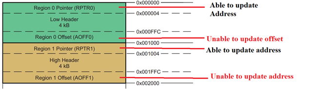

Hello Team,
I am struggling to update Region pointer oFFSET address in SPI Flash attached onboard with TPS65987EVM
I am preparing a program to flash SPI as it is our requirement in fresh production board where we are going to flash SPI ROM from Host I2C via TPS65987.
As you can see the image I am trying to update Region Pointer address and offset.
But the same procedure which I am using to update address 0x00 and 0x1000 is not working for address 0xFFC and 0x1FFC
Due to this I am not able to point the Configuration stream address.
I have tried flashing in 64Bytes in sinle go by update Bit[60] Bit[61] Bit[62] and Bit[63] -> not working
I have tried to write 4096Bytes 4KB using loop after passing Regionpointer address location i.e. 0x00 and 0x1000 but it also didn't work.
Let me know if there is any constraint to update Region pointer offset or any special procedure required?

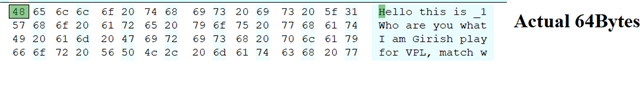

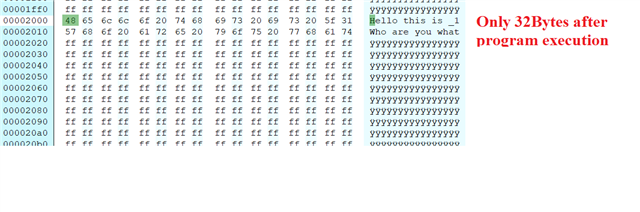

  • Hello Tommy,
    I think I found the issue. But looking for solution how to over come.
    I found that when I am passing 64 Bytes of data to INData and run FLwd, it is only wrirting 32 Bytes in the SPI flash memory. Rest 32Bytes get missed.
    As per procedure i run
    - FLem
    - FLad
    Input INData with 64Bytes
    - FLwd.
    Now when I observe my SPI memory it shows only 32Bytes of data
    Actual Array passed to INData
    Now after reading flash I get only this
    Find the log for the same

    Girish
    After adjusting Indata[] fill loop to only fetch 32Bytes from array while rest of the process is same I am able to update region pointers and location + configurartion data.
    Only I have to run loop 2 times for the actual size of configuaration data.
    Girish
