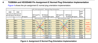

Hi team,
Could you please tell me why the DP and Lane are different in datasheet and SLLA403A app note.
https://www.ti.com/lit/an/slla403a/slla403a.pdf?ts=1641490153356&ref_url=https%253A%252F%252Fwww.ti.com%252Fproduct%252FTUSB564&_ticdt=MTY0ODYyNzMzOXwyMTYwMzg3MjB8R0ExLjIuMTkxODc0NDM5OC4xNjQ0MjA2ODUy
on datasheet page 34, it said Lan0 -> DP1, Lane 1 -> DP0, Lane 2 -> DP3, Lane 3 -> DP2
on app note page 4, DP 0 -> DP2 (Lane 2), DP1 -> DP3( Lane 3), DP2 -> DP0 (Lane 0), DP3 -> DP1 (Lane 1)
