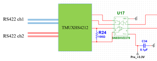

Customer want to use  TMUXHS4212, a differential mux/demux, as a multiplexer switch, please see details below.
The goal is to make our instrument going to have two different connectors. Both connectors use the RS422 protocol, only the connector specifications are different. Please refer to schematic below.

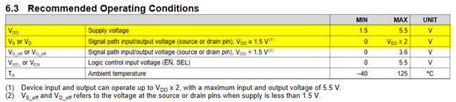

According to the datasheet, VHS-ABSMAX is 2.4V. However, the data rate of of the instrument is less than 1Mbps. Will the differential I/O voltage be limited under 2.4V? In other words, will the output voltage of SN65HVD379 to high for TMUXHS4212?
