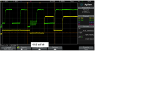

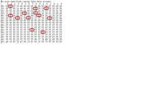

Could you help what is the reason, the data cannot be read when reading, as shown in the red circle, The information has been backfilled, please refer to.
Gareth,
As Clemens said, we need a bit more information here. An image of the communication waveform would help, a schematic of some kind would also help.
Eric Hackett
Hi Gareth,
As Clemen's pointed out, this seems like the rise time accelerators turning on and experiencing contention, I suspect this is occuring during an ACK. The VoL seen on the line also seem a little high, this could make the rise time accelerators trigger earlier since you're closer to their threshold for when they turn on.
Changing the pull up resistors/loading can help, usually making them weaker to slow down the rise time accelerators turn on.
If you're early in your devlopement, I would suggest moving to TCA9511A since it's a functional replacement to TCA4311A with improvements. The only downside to TCA9511A is the ESD rating is lower than that for TCA4311A.
-Bobby
