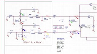

I have to protect against lightning and interferences telecommand and data lines RS422 which uses a DS26LV32AT as receiver. Therefore I would like a model of the receiver inputs to carry out Spice Simulations attacking the receiver input with waveforms about 250 V and 10 A:
1- I have tried the Ibis model but the results don´t convince me because it doesn’t include the ESD clamping diodes. I´ve developed a model by advice of other designers that you can see in file Capture1_Zin, do you think is a proper model for the inputs, let´s say pins 1 &2? Can you provide me a model of the receiver input impedance?.

  • Hi Luis,
    1.  The 5k pull-down to ground isn't present on the inputs for this device. Besides that the ibis Model looks okay - I'd double check the diode number to make sure it lines up with datasheet values - the diode data is in the ibis model listed under "PWR CLAMP" or "GND CLAMP". For this device we didn't directly spec input impedance. You can get a ball-park estimate with the VIH and IIH ratings - The max ratings are what is used based on available data in the datasheet:
    VIH = VCC = 3.3V ; IIH = 10uA --> 3.3V/10uA = 330K Ohms. For a VCC input on the input pin the max current is 10uA. It will be high impedance as this is just a simple logic input gate.
    2. The model will not give you a "Fail" code if the part would be damaged - if the parts max ratings are violated there could be major issues in terms of damage and we do not guarantee operation passed max ratings of the device.
