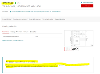

Thanks for your reply. I've been digging around. Do you think TVP7002 could work?
Reading the TVP7002 datasheet, it does look like it is for converting analog inputs to digital RGB. However, please be aware that there is no longer support from TI for this product.

Are there any chips you can suggest for my project (STANAG to DVI/HDMI) that are still supported?
Hi Jason,
Sorry, your question was forwarded to me specifically for TVP7002. As far as I know all TVP700x have no support. For products that meet your requirements that still have TI support, I will need our Interface team experts to comment.
Jason
Unfortunately we do not have a solution that can support direct STANAG to DVI/HDMI. Looking at the previous e2e post, https://e2e.ti.com/support/data-converters-group/data-converters/f/data-converters-forum/378789/need-video-adc-to-support-non-standard-video-format/1334796?tisearch=e2e-sitesearch&keymatch=STANAG#1334796. The TVP7002 may support the STANAG but as Charlies pointed out in his response that this device is NRND and no longer being supported by TI.
