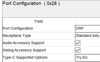

  • Hi Alan,
    I reviewed your pjt file. Have few questions below:
    1. You mentioned you need "bidirectional USB charger", I see your Port Control Register setting is "initiate swap to Source" and "process swap to source", which means that the port will always be source, to provide power to far end device.
    2. I see both inter power paths PP1 and PP2 are set as "Sink or Source" in Global System Register; and in Transmit Source Capabilities Register, PP1 used to source 5V PDO and PP2 used to source other PDOs, however, from your schematic, VBUS1 & VUBS2 are connected together, PPHV1 & PPHV2 are connected together. I'm confused about how your design your power rail? Generally, according to our EVM, if bidirectional use is needed, one PP is used as Sink Path and the other PP is used as Source Path, such as PP1 as Sink Path, PP2 as Source Path. When power flows in, it will go through PP1; when power flows out, it will go through PP2.

    If this is the design you have, I think you may need the charger to control the power flow. The 987D can indicate the power role of the Type C port, and the charger needs to determine the power flow according to this power role.
    Besides, I see there are four source PDOs in your pjt file, 5V/ 9V/ 15V/ 20V with max power 60W. According to my understand, these four source PDOs voltage are all generated from the charger, I need to confirm how the system drive these PDOs.

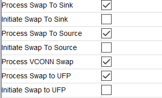

    PP1 is used as sink, PP2 is used as source, i disabled Power Duo mode in order to not have both closed at the same time (that's not the use case)
    I selected process swap to sink and initiate swap to source because what i understood is that process swap to sink will order to the TPS to be sink everytime is possible and then being source only when a small device is asking to be charged. Is it the correct options to select ?

    Please see the change. "Initiate to source" means if PD is not source, it will always request to swap to source. "Process to source" means if the far end device wants PD to be source, PD will accept the request. From you application, I think both sink and source with "process  swap" is more reasonable. And with the setting of "Try Source", PD here will be a weak Source. For example, if the far end is an adapter, the adapter is a strong source device, it will always be source. When a weak Source meets the strong Source, it will be a Sink. If far end is a small device needs to be powered and it is compliant product, it may be able to a dual role power device or weak Sink. When a weak Source meets a dual role power device or weak Sink, it will be a Source.
    The "priority" is as below:
    strong Source (DFP, initiate to Source, no Sink) > weak Source (DRP with Try Source, process to Source/ Sink) > dual role power device (DRP, process to Source/ Sink) > weak Sink (DRP with Try Sink, process to Source/ Sink) > strong Sink (UFP, initiate to Sink, no Source)
    Hope this will help you understand.

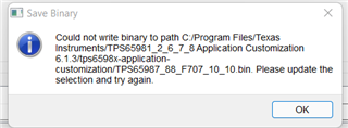

  • https://e2e.ti.com/cfs-file/__key/communityserver-discussions-components-files/138/6825.TPS65987D_5F00_Update_5F00_Prog
    Hi Alan,
    The bin file cannot be saved in GUI's folder so you cannot save that. You need to save in your own folder. I generated full flash binary, you can flash it to FLASH directly through a flash tool.
    I will get back to you the test result on EVM when I back to office.
    Thanks.
    Bing

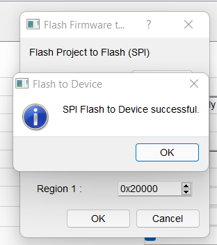

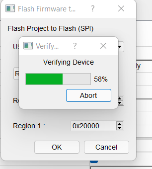

  • Hello Bing,
    I tried to make a flash upload from you bin but it seems broken. As you can see on the screenshot below, the firmware version is: ffff.ff.ff and the allocated configuration size is 0xfffffff
    Plus, i can't upload it inside the flash memory
    I copy paste the TPS65987D EVM Backup bin file and i saved the project on it using "Low Region (Full Header)" save.
    The Binary file has been updated correctly and i could upload it inside my board but i still can see a change on the behavior of the board and i still don't find my parameters when i go in Debug mode it's still in manufacturing default configuration.
    I add also the Bin file as attachment so that you can test both project and bin file (i hope that the Zip compression will not change the Bin files data, i can't upload the bin files for security reason)

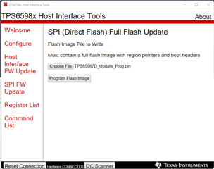

  • Hi Alan,
    The bin I generate is the full bin. Full bin is used to flash to FLASH directly.
    Thanks.
    Bing

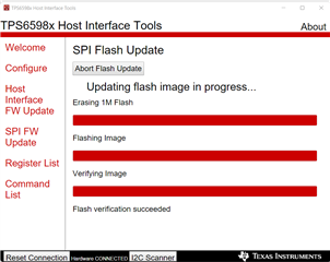

  • Hi Bing,
    I tried to update the full flash using the TPS6598x Host Interface tools with your file
    it seems to work properly but once again when i go into debug mode all my parameters are deleted and the TPS is still in manufacturing default mode, any idea ?
    I'm using the following flash which should be fully compatible:
    W25Q80DVSSIG
    Best regards
    Alan

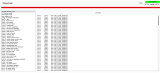

  • I tried to connect through I2C2 i observ the same behavior.
    The configuration uploaded before, disapear in debug mode even when the flash upload do the 3 steps Erase Programming Verifying without any trouble.
    i downloaded the PD state machine here is the result below:
    i can read multiples lines of  : Port 0 Type-C 0x0 = SRC_STATE_DISABLED
    I try to upload the FW in debug mode through the section "HI Firmware update"
    But when i'm doing "read boot status" i can read "Boot FAILURE"
    Alan

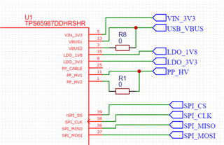

  • Hi Bing,
    Thank you for your answer,
    See below the flash SPI Part of my schematic, I think this is exactly what you displayed above. Please, see also the TPS65987 Side to check if the MOSI/MISO Pins between the flash and the TPS are correctly connected.
    Best regards

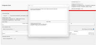

  • Hi Alan,
    The codes you flashed to SPI FLASH is based on GUI 6.1.2 or GUI 6.1.3?
    Bing
  • Hi Bing,
    It's based on GUI 6.1.3 i tried to update the GUI since it was not working properly on 6.1.2 with my board but it doesn't change the behavior observed above

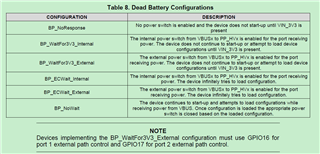

  • Hi Alan,
    You should be able to refer to datasheet Page 44:
    We have different settings determining PD's Dead Battery Boot behavior. It is determined by ADCIN1. You should choose the write setting.
    Thanks.
    Bing
  • Hi Bing,
    I think that i should take the BP_ECWait_Internal instead of BP_NoWait (currently this one on the board). Because the TPS needs to charge his configuration in deadbattery mode (i don't know if it's possible) and then to precise to the BQ25723 to be OTG by I2C after it the TPS will be no more in deadbattery mode and the Board should start correctly.
    So is it possible to charge the configuration in dead battery mode by choosing "BP_ECWait_Internal" ?
    Thank you,
    Best regards
    Alan
  • Hi Alan,
    BP_NoWait should be useful. With BP_NoWait, when 5V on VBUS, PD can be powered from 5V, and starts to load FW. Did you see VBUS with 5V when you do re-connection after you flash the FW to the SPI FLASH? And what is the status of LDO_3V3? It is used to power the SPI FLASH.
    Thanks.
    Bing
  • Hello Bing,
    Sorry for my late answer, the USB VBUS is at 5V, the LDO_3V3 is at 3.3V (powered by internal LDO through USB VBUS power)
    The internal switch remains openned.
    The internal switch became closed only when I pull down the SPI_MISO Pin (It's the default configuration)  but the charger doesn't charge the battery because the BQ25723 need to be driven by I2C From the TPS and so in default configuration, the I2C parameters aren't stored into the TPS
    So it's still an issue on the FW loading but i don't understand why when the SPI pins are correctly connected between the TPS and the Memory and i changed the memory reference to use the same than the TPS65987EVM

    1. How you flash the SPI FLASH? I assume you use FTDI to flash directly right?
    2. Which I2C group do you use to enter debug mode?
    Thanks.
    Bing
  • Hello Bing,
    Based on your comments above i've made a V2 of my prototype charging board
    Is it possible for you to make a quick verification of the schematic ? (you can find it below as attachment)
    I would like also to verify the BQ25723 part should i make an other post for it ?
    Thank you very much for your support
    Best regards
    Alan
    Schematic_Bidirectionnal USB_C Charger_V2.pdf
  • Hi Alan,
    For your latest schematic, for PD controller's part, it looks good to me. For charger's part, you'd better submit a new e2e thread and label it with charger's part number, and the expert from charger's product line will give you some suggestions if needed.
    And by the way, can you please share more details about mode transition? I mean, if battery is out of power, then the board can only be Sink; and if battery is with power, (maybe not much but is yet able to power TPS65987DH through VIN_3V3), the board will always be Source. -----> Is this the expected behavior you want?
    Thanks.
    Bing
  • Hello Bing,
    Many thanks for your review,
    Yes that's exactly the kind of behavior i'm expected.
    The board need to always be in source mode when the battery has still a bit of power to charge small devices such as smartphones or others things.
    And of course if i'm charging the board with an 220V AC charger Power Delivery which can be only source the board has to switch in sink mode to charge the battery even if the battery is still a bit charged.
    Thank you
    Best regards
  • Hi Alan,
    That's good. Because in Dead Battery Mode, the PD will limit the output PDO voltage level to 5 V. (VIN_3V3 is powered later than VBUS, the PD enters Dead Battery Mode). But now for you application, the situation may not occur, that's okay from my review.
    Thanks.
    Bing
