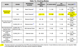

   For the ESD, we changed 954 register 0x58 to 0x5D and 953 register 0x06 to 0x21 for changing BC frequency to 25Mbps. After changing that, the i2c payloads cannot be passed through 954/953 to camera sensor. Is there any other registers should be adjust? We have another platform with the same 25Mbps settings,it can work fine.
regards,
Sean
  • Hi Sean,
    1) It seems your original 953/954 setup is in Synchronous Mode, with a FC rate of about 4Gbps and a BC rate of 50Mbps. And you had a stable LOCK, with no issues sending I2C commands to the remote I2C bus. Can you confirm if this is correct?
    If so, then in order to switch to a 25Mbps BC rate, you would first need to enable RX_WRITE_PORT_0 on the 954 (reg 0x4C = 0x01) and then set the Back Channel to 25Mbps (reg 0x58 = 0x5D).
    You do not need to write to reg 0x06 in the 953 device, to configure the BC rate. In Synchronous mode, the 953 will take whatever BC frequency the DES sends and use it to drive the Forward Channel. Reg 0x06 in the 953 device is used to configure the CLKOUT signal.
    2) After switching to the 25Mbps BC rate, can you confirm that LOCK is still stable and HIGH, by reading register 0x4D in the 954 device.
    Some additional info:
    Frequency of the REFCLK sent to the SER in Synchronous mode is half the BC bit rate, so if the BC is set to 25Mbps, then the REFCLK to the SER is about 12.5MHz. You can use Table 7-6 in the 953 datasheet to calculate the new data rates, if you lower the BC rate.
    Make sure that your system still meets the CSI Bandwidth and CLK_OUT specs, with the new BC rate.
