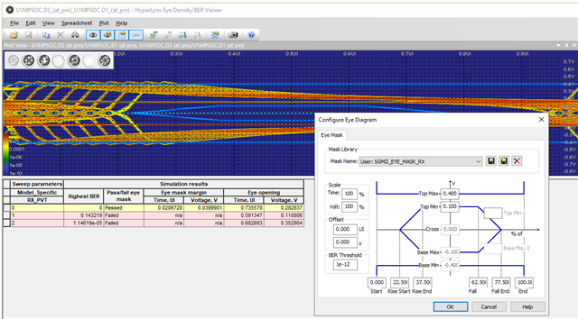

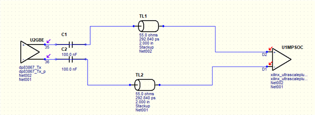

DP83867E: Xilinx Zynq Ultrascale+ SGMII mode with TI DP83867 PHY EYE MASK Issue
Failing eye mask for SGMII Receive signals for Typical and Fast strong Corner between DP83867 and Ultra scale plus GTH receivers.
I ran the linesim simulation bwn the Driver Phy and receiver GTH MPSOC with short trace length of 2 in and assigned the respective AMI models for both transmitter and receiver.
This issue is common irrespective of no of vias and trace length and capacitor placement. I suspect the issue models. Please help me with the resolution.
