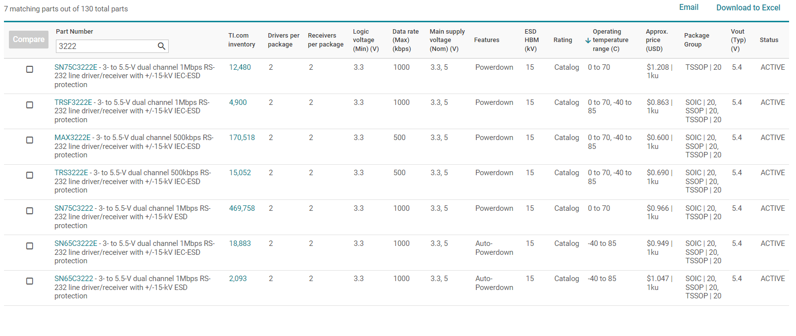

Do we have any p2p solution for the TRS3222ECPW in package (TSSOP) (20) ?

    Yes we have a few parts that will meet that need.
    The devices with an "E" at the end of them will be closer to what you what to see. The C version of the part is the lower temp grade so some of these parts are the "I" version which indicates -40C to 85C instead of the 0C to 70C (so replacing a "C" with an "I" will not negatively affect the system)
    Some of these devices also have a higher max data rate - but can still support the lower data-rate systems.
    The closest part would be the MAX3222E - but any of those in the above list should be more or less drop in matches.
    Please let me know if you have any other questions!
