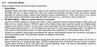

SN65LVPE512RGER has the following three modes, how long will it wait for the IC to enter U2/U3-mode or enter Rx-Detect-mode?
For example, after VCC is powered on, how long will it enter the Rx-Detect-mode when the upstream or downstream device is not detected?
How long after detecting the device does not receive the LFPS packet, will it enter the U2/U3-mode?
