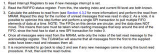

    Once again, the ability to do a bulk transfer will be based on how you write your code. With your current device you should be able to preform a bulk data transfer. Here is the procedure outlined in section 5.3:
    If you follow this procedure you should be able to read in messages with one SPI transaction and then send the index of the last message to the acknowledge register. This will release all the messages that you read. This greatly shortens the amount of time you have to spend writing to the acknowledge register after every SPI read. There is a warning however in section 5.3 so I highly recommend reading through the whole section to make sure that your FIFO does not overflow. This happens while you are reading multiple messages in the FIFO and you haven't sent the acknowledge bit yet. If more messages are coming in your FIFO could start overflowing and your messages could be lost.

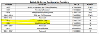

  • Hi Aysha,
    What Interrupt are you checking? When you receive a message the M_CAN_INT interrupt flag should be thrown letting you know that the MCAN device has an interrupt. Once you receive this interrupt you should then read the interrupt register 0h1050. This will give you information on where the message is stored and if your RXFIF0 has a new message:

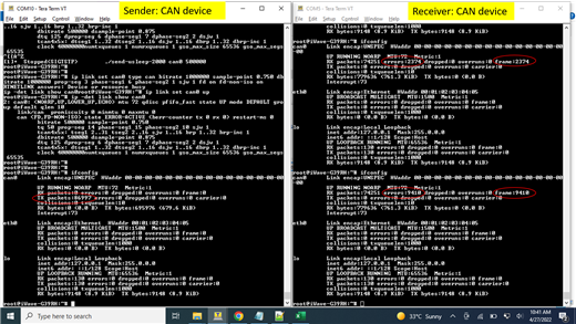

  • Dear Chris,
            We were sending 8 bytes of CAN data continuously every 2 milliseconds and CAN data were getting received successfully. But sometimes, on receiver side error was detected for a frame and there after all received frames were rejected as error frames as highlighted in the below attached console image. The ifconfig command was used to capture the status.
    To recover from this error condition, CAN link has to be made down and up on the receiver side by giving following command and rerun sending and receiving programs.
           # ifconfig can0 down
           # ip link set can0 type can bitrate 500000 sample-point 0.750 dbitrate 500000 prop-seg 3 phase-seg1 6 phase-seg2 1 sjw 1 fd on fd-non-iso on
           # ip link set can0 up
           # ip -det link show can0
    Why this error situation is happening? How to recover from this error state without link down and up. Since link up and down consumes some time to execute and by that we may loose many frames. Is there any reset or some other methods to recover immediately from error state without losing much frames. Is there register that we have to monitor to check this error state and take action?
