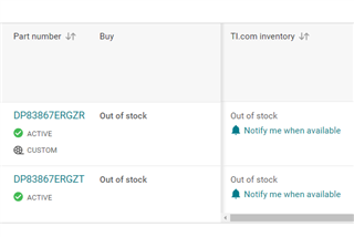

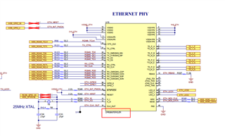

At present, I see that the TMDS273GPEVM Ethernet chip DP83867E is out of stock on TI's official website. Is there any alternative solution to recommend?
Thanks.

I see that the interface being used is RGMII. So any of the DP83867IS, DP83867IR, DP83867CS, DP83867CR can replace this PHY.
Please note the temperature rating difference between these PHYs.

Hi
I searched for these PHY chips, and they all showed the status of being out of stock. Is there a replacement solution in stock?
Or are other PHY chips with RGMII interface available, and are there major differences in the related protocols and software drivers?
Thanks.

Other than the PHYs I have mentioned above, there are no other PHYs which are hardware and software compatible with DP83867E.
