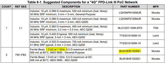

    On a side note, I noticed that the PoC network is structured similarly to the recommended 4G PoC network, provided in the UB953 datasheet, but the components do not match what we recommend in the datasheet.
    For example, the Ferrite Beads in the UB953 datasheet are recommended to be 1.5-kOhms@100MHz, but the Ferrite Beads that were used vary between 331-Ohms@100MHz and 470-Ohms@100MHz.
    This means the customer is using a custom PoC network and will need to verify that their PoC network will cause no issues in their system. Customer also needs to verify that their PoC network will support the current being drawn. Our recommended 4G PoC network supports up to 150mA.
