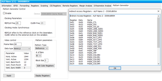

Hi ,
Can I please get values of patgen registers to program into the 954 for
RAW12, 1944x1204 , 60fps

Hi Suhas,
The 954's Analog LaunchPAD Pattern Generator Tab can be used to program PatGen registers directly if 954 is hooked up via USB2ANY/Ardvark. Otherwise, it can still be used to generate register values by programming your settings into the fields and hitting Display Registers, as shown below:
Logan
