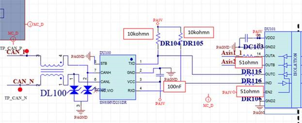

TCAN1044V: schematic
Part Number: TCAN1044V
Other Parts Discussed in Thread: SN65HVD251, ESD2CAN24-Q1
Here is the schematic with TCAN1044VDRQ1. Could you help to if there are something missing?
application: AC Inverter
Data rage: 5Mbps
TVS component on CANH and CANL bus: NUP2105LT1G
The termination resistor is located at end termination CAN, here doesn't show it.
Both TXD and RXD pin are connected to isolator via 51 Ohm for noise immunity, do you suggest this?
What else in the schematic you would like to suggest? thanks.
