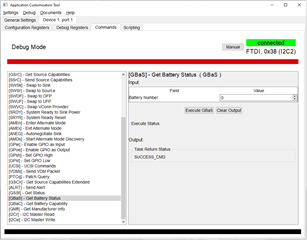

  • Hi Prajith.  Thank you for trying to help me.
    I don't have a i2c trace to share with you, but I can tell you what I am doing...
     1. I am using the TPS65987EVM boards with the TPS6598x Application Customization Tool (version 6.1.1 or version 6.1.3) in Debug mode.  I have one TPS65987EVM connected to a laptop and another one connected to a desktop computer.
    2. It is my understanding that the battery normally resides on the sink side of the USB-C cable.  So, I have one TPS65987EVM getting power from the 19V connector (Source) and the other TPS65987EVM being the sink.  I connect the USB-C cable between the EVM boards and I observe that the source EVM has illuminated the 20V LED, meaning it is sourcing 20V.  After the power contract has become active, then I connect the TPS65987EVM to the computer via the USB-micro connection.
    3. On the EVM that is the sink, I type in a battery "2" and I give it a charge value of "0x00ff".  Then, I click the write button.  It comes back and says it was "write success".  Note, I have this panel in "Manual" mode.  If I run the Debug tool in "Polling" mode, any changes to this panel does not take.  Instead, the battery will reset to "255" and the State of Charge will go to "0xffff" after about 2 seconds.
    4. Then, on the EVM that is the source, I go to the Debug Commands panel and select [GBaS], Get Battery Status.  I click the button "Execute GBaS".  It returns SUCCESS_CMD.

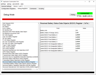

    5.Then, I go to the Debug Registers tab and select the Transmitted Battery Status Data Objects (BSDO) Register and look at the information.  The data there is the default values of batteryInfo "255" and Battery State of Charge (SOC) "0xffff".  The values have not changed.

  • Hi John,
    I tested it using two 88DH EVM and GBaS command works fine. Please find the screenshots below.
    Also, please check if you are Vconn provider.
    Prajith
