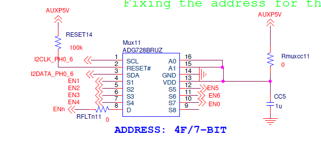

PCA9546A: PCA9546A not passing through the I2C commands to the devices after the switch
Part Number: PCA9546A
Hi TIer,
I changed the schematic based on the inputs I got from the E2E and here is the schematic.
At CH0, I have four I2C MUX connected, and here is one of them.
I am using a PMBUS to run the communication. I can write to the PCA9546A and read back using address 0x70. I am writing "00000001" to turn on CH0. But I was not able to reach out to address 0X4F as shown in the schematic, and when I sent a command there, I got a False return code. In another design, without the I2C switch, we are able to communicate with the 0X4F without a problem.
Do you see any problem with the schematic and any suggestions?
