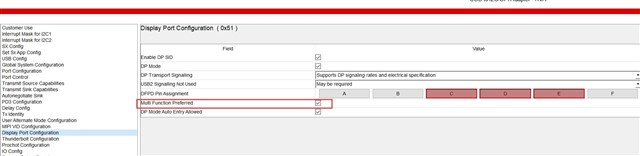

What is used for Multi Function Preferred in PD FW? Is this option required when using Thunderbolt4 or DP Alternative mode?

Multi-Function: supports simultaneous transport of USB Super Speed and DisplayPort over two (2) lanes of the connection.
This option is for DP Alt. mode and it is up to the user to decide if this functionality is needed or not.
