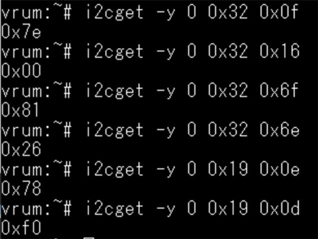

  • Hello Blake,
    I also tried your register settings on the EVMs and can confirm that the software register settings are correct. If you write the registers in the order that you wrote in your post, then the GPIO mapping should work. If you apply a HIGH signal to GPIO6 on the 936, then GPIO0 will also go HIGH on the 935.
    1. Are you able to confirm through local and remote I2C reads that all of the registers have been correctly written on the 936 and 935 devices?
      1. Maybe an I2C write command got lost somehow?
    2. Is there anything connected to GPIO0 on the 935, that could be pulling the signal LOW?
      1. Check the schematic and maybe probe around to see if an LED broke or if there is an accidental short to ground?
    Justin Phan
  • Hi, Justin,
          About i2c write command got lost possibility, I think it should be impossible. Because current our video streaming is working, and we have let several i2c devices working properly at ub935 side.
         The 4 GPIO of ub935 were wired to a device's SPI interface, and we plan to use it to transfer SPI signal. Since I found the host output clock can't transfer to UB935 side, so I have change host side SPI pin to generic GPIO for testing this issue firstly.
    Thank you,
    --Blake
  • Hi Blake,
    If you are streaming video from the SER->DES, then that means the Forward Channel is working. But it is possible that the Back Channel may not be working if the BC rate on the SER/DES are not configured correctly. This is easy to check. Just send a remote I2C read command from the Processor->DES->SER and read some known register value on the 935 SER. If the result is correct and not 0, then that means the Back Channel communication (DES->SER) is working.
    If you can confirm that the 936 and 935 have all of the registers written to the expected values, then I would suspect that GPIO0 on the SER is shorted to ground.
    Justin Phan

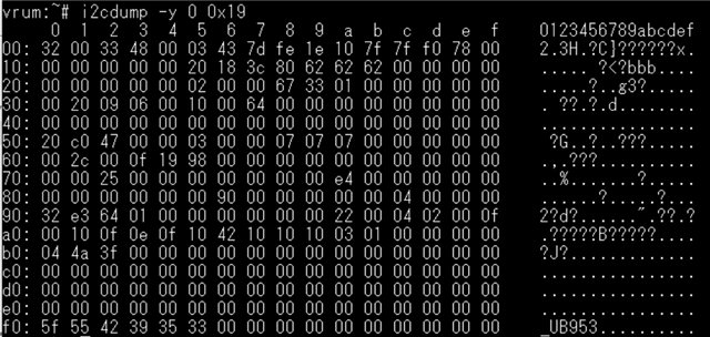

  • Hi, Justin,
         Okay, got it.
      I just check UB935 REG 0x0 to get SER ID and it's correct as we expected 0x32.
         How do I confirm the back channel is working properly? Below dump data from UB935, could you help to check has any back channel related setting incorrect?
    Thank you for the help.
    --Blake
  • Hello Blake,
    If you can properly send a remote I2C read command from the Processor->DES->SER and read a correct register value from the 953, then your Back Channel is working.
    I also did a few more tests on an EVM setup. In your setup, you are reading register 0x53 on the 953 in order to view the status of GPIO0 on the 953. This register will only show the status of the GPIO pins on the 953 if the GPIO pins are configured as inputs. In your setup, GPIO0 is configured as an output, so register 0x53 will not show the state of the GPIO0 pin. It is expected for register 0x53=0x00 in your setup.
    I see where the confusion is though, since the datasheet specifies that this register can be used to read the GPIO status, regardless of how the GPIO pin is configured.
    This description is wrong. I tested using EVMs. Here is the configuration you provided and what I tested on the EVMs:
          UB936:
             REG(0x0F) = 0x7e  // bit 6 = 1 enable GPIO6 as an input.
             REG(0x16) = 0x00 // disable GPIO6 output function.
             REG(0x4c) = 0x01 // Enable write to port 0
             REG(0x6e) = 0x26 // bit[0:3] Mapping GPIO6 to BC slot 0 at RX port 0
          UB935:
              REG(0x0d)= 0xf0 // Output source of GPIO0(bit 4) to BC slot 0 in the connected remote deserializer
               REG(0x0e)= 0x78 // Enable GPIO0 output(bit4) and disable GPIO0 input(bit 0)
    When you apply a HIGH signal to GPIO6 on the 936, then the GPIO0 pin on the connected 935 will go HIGH. I verified this by using a DMM to probe GPIO0 on the 953/935 EVM. Reading register 0x53 on the 953 cannot be used to determine the status of the GPIO0 pin on the 935.
    Your script is correct and can only be confirmed by probing GPIO0 on the serializer with a multimeter.
    I will submit a request to correct this sentence in the next revision of the 953 datasheet.
    Justin Phan
