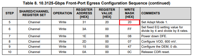

Hi Team,
I believe the following red part "20" is typo and "60" is the correct.
Is my understanding correct?
https://www.ti.com/lit/an/snla323/snla323.pdf

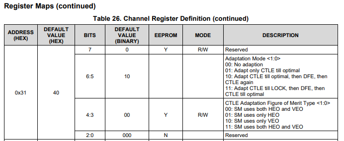

Regarding DS110DF111 datasheet, the default value of 0x31[6:5] is "10" and we should program "01" in this case.
If so, WRITE MASK should be "60".
Yaita
