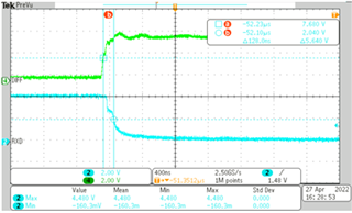

    We have tested the propagation delay of Vdiff signal w.r.t. to TXD and RXD and those values also differ from the datasheet values, pls refer below waveforms and test data.
    Loop delay is not tested yet TXD and  RXD i.e. tLOOP1 and tLOOP2.
    As you have mentioned, no cabling ,secondary transceivers or external loads were used for datasheet values, the below results lies in same category as in my initial post.
    Although loop delay values should match with the one present in datasheets. Is this understanding correct?

  • Hi Sunney,
    For the driver characteristics, it seems only the measured dominant-to-recessive (tpHR) time is larger than expected. This transition is not actively driven by the transceiver and is mainly a characteristic of the network, namely the differential capacitance discharging through the termination resistance. Are the load conditions for this test the same as the datasheet values? Without the 60-ohms of termination between CANH and CANL, I would expect this transition to be slow as there is no external discharge path between these signals.
    For the receiver characteristics, it appears the measurements were taken in reference to when the Vod reached 50% of its final value. The datasheet characterises this time from when Vod reaches the defined CAN recessive (0.5V) or dominant (0.9V) thresholds, so this may be a source of discrepancy between the values. The bus load mentioned previously will also impact these measurements as different load conditions will mean the slew rate of the Vod transition is different.
    Also, I'll mention that the loop delay times are not necessarily tpHR + tpRH or tpLD + tpDL. Because the thresholds of the receiver are different from the measurement thresholds, this combined loop time will be shorter when measured directly.
    As we do not specify maximum values for these characteristics on the datasheet, it is difficult to point to these measurements as a discrepancy for the device. Is there a specific concern that the customer has regarding this behavior and how it impacts their system? Or are these parameters required for a different part of their specification? If their main concern is to verify datasheet values with unit performance, I would encourage the customer to measure the loop delays as these are better defined in the datasheet and more applicable to system behavior.
