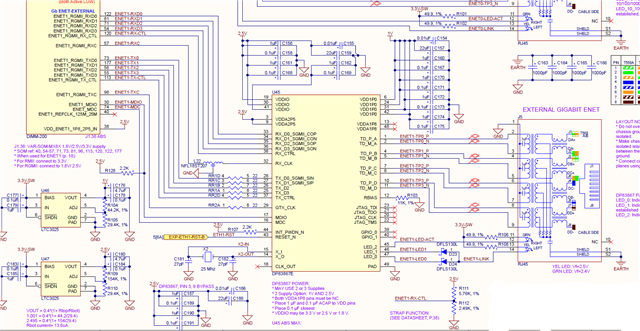

Currently debugging yocto based embedded system using DP83867E for our Phy.
I am able to communicate with the phy through MDIO, doing a register dump I get the following in u-boot:

Looking at td_a_p and td_p_b I can see the keep alive pulse but nothing else when I connect rj45 cable.
    Can you please describe the cable you are using? What type and length is it?
    What is the link partner of this PHY? What is the desired speed of your application? It appears you have autonegotiation set for 100/1000. Does the link partner have their auto-negotiations set for these speeds as well?
    Can you provide datasheet of RJ-45? I am concerned that the PHY to RJ-45 connection may have been set incorrectly.
    Sincerely,
    Gerome
  • Hello Gerome,
    Currently using a 6ft cat 6 cable into a tp-link tl-sg1005d gigabit switch.  looking up the datasheet for my switch it appears to support autonegotiation for 10/100/1000.  Desired speed can be 100mbs using for basic telemetry.  RJ45 port is a pulse JXD2-0015NL
    productfinder.pulseeng.com/.../JXD2-0015NL.pdf
  • Hi Walter,

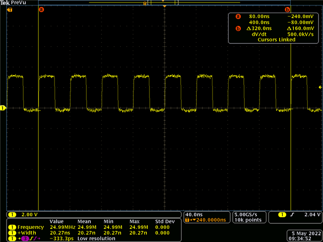

    Can you please measure CLK_OUT and ensure that it is +/- 50 ppm?
    Can you also please read registers 0x6E and 0x6F and report back values? These are extended registers and will require extra steps to access. Please see section 8.4.2.1 for more information.
    Can you also read register 0x1 multiple times over? As well as register 0x11?
    Can you also confirm voltage measurements on power pins as well as INT/PWDN and RESET?
    Can you try other link partners as well as cable types and lengths?

  • Measuring off of pin 18 seems to be pretty solid
    https://abracon.com/Resonators/abm7.pdf
    according to datasheet crystal should be 30ppm stable.

  • Hello Walter,
    It appears from the register information that RX_CTRL was not properly strapped. You do have the correct resistors designed into the schematic, but there may be something else driving the node that the pin is sampling off of. It could potentially be the MAC setting an external voltage in the middle of the resistor divider strap network. This configuration only works assuming that it is the only thing setting the voltage at the pin at the time the PHY is sampling. If the MAC is driving the lines for whatever reason, this can cause different voltages to show up and thus, a different mode for the PHY to go into.
    A fix for this is located at footnote 1 of table 6. Please set bit[7] of Reg 0x31 to '0'.
