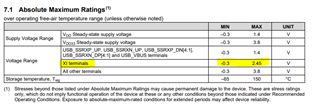

I was looking at the requirements when using an external oscillator instead of a crystal for clock generation.
Section 8.3.6 of the datasheet says: “XI should be tied to the 1.8-V clock source…”
Is 1.8V really correct?
The reason why I’m asking is that I can’t see any reason why this should work with a 1.8V clock as the supplies are defined with VDD33=3.3V and VDD=1.1V.
Also the input logic levels are defined as:
VIH_min = 2V
VIH_max = VDD33
Additionally I can’t find any specific logic level definitions for XI input, so I would assume that I need a 3.3V clock source?
Could you provide some insight here? Looking forward to your inputs!

  • Hi Simeon,
    Yes, the clock cell is a 1.8V cell.  The Vih is defined for the external inputs and bidrectional buffers only, not the clock input.  The max range of the XI pin is listed here:
