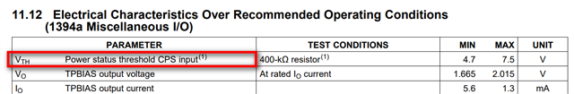

2.CPB input threshold voltage is 4.7V ~7.5V, but CPB connected 12V bus power of XIO2213EVM, so what is the maximum bus power ?
    The maximum bus power supported is defined by the PCIe specification is up to 75W depending on the type of slot that is designed. The CPS pin is typically used to detect cable power dropping below the threshold voltage, but if it is not being used it may be connected to Vssa as described in the datasheet. It seems like the bus that is providing power is determined by fuses on the EVM. The PCIe bus has a 0.5A fuse, so 0.5A*12V=6W. What is the concern regarding the maximum bus power?
