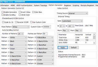

  • Hi Tommy,
    Yes, you can enter the required timing parameters into the PatGen tab inside ALP:
    The PCLK will be slightly off depending on the M/N divider; but this will still create the desired timing and slightly modify the refresh rate based on the actual PCLK from divider/internal CLK tolerance.

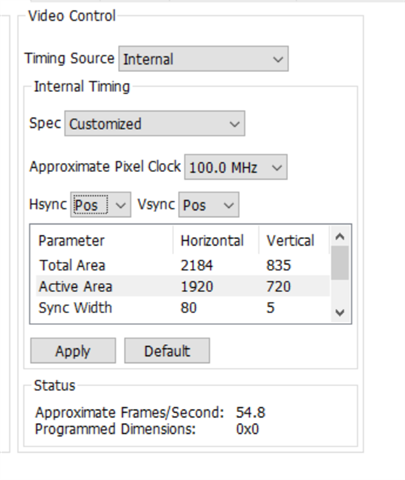

  • Hi Logan,
    I have tried to modify my LaunchPAD. seems PCLK setting is a option with max 100MHZ. so basically we could not set to exactly same 109.42 MHz by this method, am I correct?
    By the way, is there a standard setting value for sync, back porch. front porch H/V if we only know total area/ active area H/V?
    Tommy
  • I have tried to modify my LaunchPAD. seems PCLK setting is a option with max 100MHZ. so basically we could not set to exactly same 109.42 MHz by this method, am I correct?
    That is correct. Which device profile do you have selected in ALP? When I pull up 949 in demo mode, I'm able to slightly closer by modifying the M/N values to 106MHz (58Hz). All in all, the PCLK will vary up to 10-20% percent anyways due to internal CLK accuracy, so as long as the panel can support slightly different than 60Hz, you should be fine.
    This will be specified by the panel/display. Some displays have strict timing, while others not so much.
