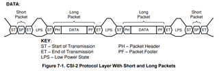

    The video throughput calculation does not include an extra parameter to estimate blanking. In terms of the supported technical specs of the 953, you just need to consider the active video and the CSI-2 overhead, which is extra signal bandwidth that is caused by the CSI-2 packet header, footer, and LPS surrounding the actual video data that is being transmitted.
    Here is a figure pulled from the 953 datasheet:
    The below calculation is correct in calculating the Video Throughput of the connected camera/imager, which needs to be less than the supported technical specs of the 953 (3.328Gbps if 4 CSI-2 data lanes are used).
    Video Throughput = HActive x VActive x (Frame Rate) x Bits-Per-Pixel x Overhead(Assume 25% if unknown)
