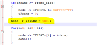

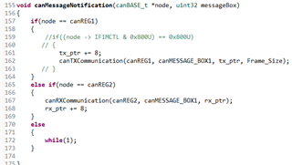

Hello. Thank you so much for your answer last time. I have a problem with CAN interrupt today, so I would like to ask you a question.
First of all, I wrote a code to receive RX data by sending TX data from CAN1 IF1 to CAN2 IF1. However, we found a problem where the interrupts of CAN1 continue to occur when TxIE of CAN1 IF1MCTL is disabled. Of course, we can use conditional statements to stop data transmission, but I don't understand the reason why the interruption continues even if we disable TxIE.
So I asked you this question just in case how to solve the interrupt problem.
Thank you for reading it. Please give me a lot of advice and criticism.

void canTXCommunication(canBASE_t *node, uint32 messageBox, uint8 *data, uint32 Frame_Size)
    int i = 0;
    while((node->IF1STAT & 0x80U) == 0x80U)
    cFrame++;
    if(cFrame >= Frame_Size)
        node -> IF1MCTL &= 0xFFFFF7FF;
        cFrame = 0;
    node -> IF1CMD = 0x87;
    for(i=0; i<8; i++)
        node -> IF1DATx[i] = *data;
        data++;
    node -> IF1NO = (uint8) messageBox;

void canMessageNotification(canBASE_t *node, uint32 messageBox)
    if(node == canREG1)
        //if((node -> IF1MCTL & 0x800U) == 0x800U)
            tx_ptr += 8;
            canTXCommunication(canREG1, canMESSAGE_BOX1, tx_ptr, Frame_Size);
    else if(node == canREG2)
        canRXCommunication(canREG2, canMESSAGE_BOX1, rx_ptr);
        rx_ptr += 8;
    else
        while(1);
