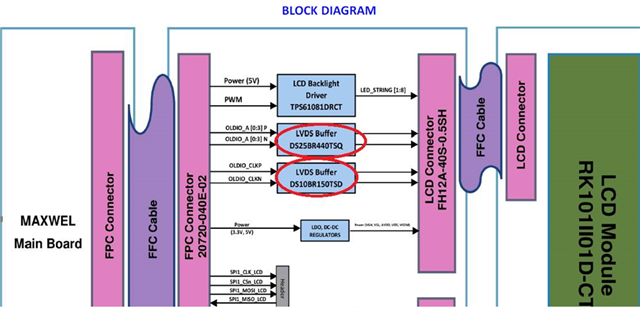

Hi team,
why this reference design use different redriver to compensate?
is there a different need for clock and signal of LVDS?
  • Hi Fred,
    OLDIO_CLK clock is sub-multiple of the data rate. On the other hand, OLDIO_A[0:3] has higher data rate. This is why we have two different parts.
    Also, DS10BR150 carries one differential clock pair versus DS25BR440 carries four differential pairs.
    Regards,Nasser
