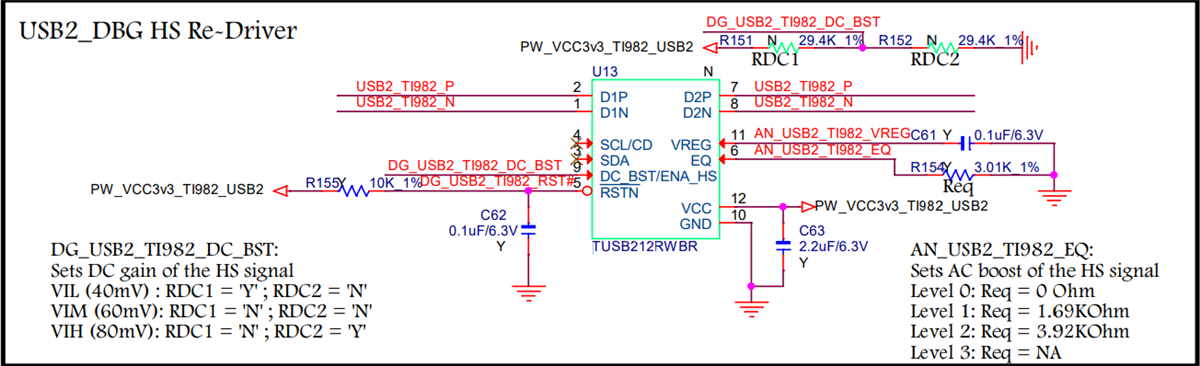

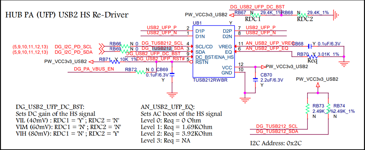

Would you please help to review below TUSB212 schematic?
Please let me know if any need modify or there have any other information you need. thanks!
