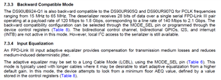

My customer first use 924 and don't know how to configurate the MODE_SEL pin.
1. When is LCBL mode needed to enable? Is there a specific cable length range?
2. When is BKWD mode needed to enable?
3. If customer don't need the I2S transmission, choose I2S_B=L right? Do they need any other configuration?
