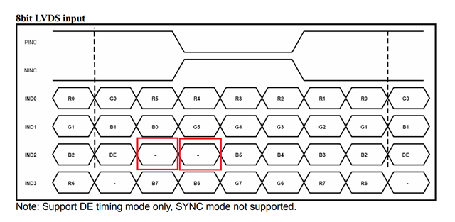

Hello.
I would like to know what to do when the display is in DE timing mode only, meaning, there is no need for Vsync or Hsync.
Do I need to supply the correpondent pins with GND or I simply don't connect them?
Here is a picture from the display datasheet. The highlighted part of the sequence is where normally the Hsync and Vsync would come in, correponding to the TxIN25 and TxIN24 of the DS90C385A. What do I do with those pins?
If any other information is needed i'm happy to share with you.
Thanks in advance!
