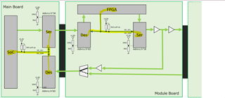

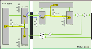

Hello team,
They are using following devices.
Serializer DS92LX1621SQE/NOPB
Deserializer DS92LX1622SQE/NOPB
The customer was unable to R/W to a register without access via I2C communication during the following conditions.
Do you know the cause?
10kΩ pullup(+1.8V)/ RCAD = 0Ω
Address 7'bit Ser:h'58 Des:h'60 -> Unable to R/W
Also, the customer is able to R/W under the following conditions.
10kΩ pullup(+1.8V) RCAD = 2.0kΩ
Address 7'bit Ser:h'59 Des:h'61 -> Able to R/W
10kΩ pullup(+1.8V) RCAD = 4.7kΩ
Address 7'bit Ser:h'5A Des:h'62 -> Able to R/W
