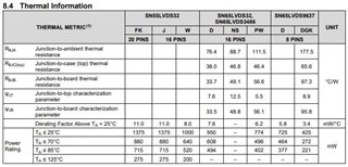

The datasheet appears to missing thermal resistance data for W package. Do we have this data?

Please give me couple wks to request the thermal model data for this device.
David
Result- Theta JA-High K (standard datasheet value) 146.8
Result-Theta JC, top (standard datasheet value) 80.2
Result-Theta JB (standard datasheet value) 135.8
Result- Psi JT (standard datasheet value) 57.3
Result- Psi JB (standard datasheet value) 123.7
Result-Theta JC, bottom (standard datasheet value) 14.2
Modelling Assumptions
Rth-JC bottom is evaluated for completeness; package is not to be soldered to PCB.
